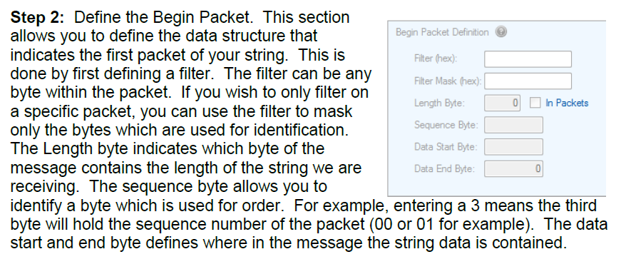

This section in the core reference manual is unclear. It says, for example that 3 is the third byte. Then you would expect to be able to define that the data end byte to be 8, but it will automatically change to 7.
Do you start countning from 0 or 1?
- Manual.png (91.4 KiB) Viewed 120 times

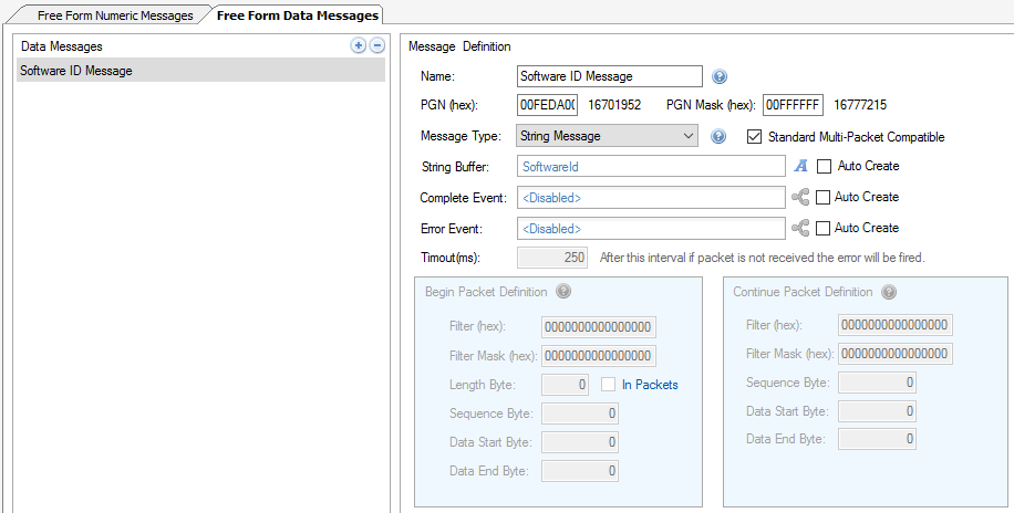

Re: Receive NMEA2000 pgn 126996
I've included a configuration that I received from one of the developers. It's not the NMEA product information PGN but it is similar. I think the main thing to notice is that the PGN field and the Mask includes the space for the source address, really the entire CAN ID. But the Mask is used to select the PGN. The example configuration did not use the Packet Definition fields, she said you didn't need to.
There is a script that shows receiving the message and picking the data out of the SoftwareId reserved string.
I think the main issue is knowing how to define the PGN and Mask fields for the Free Form Data Message.
