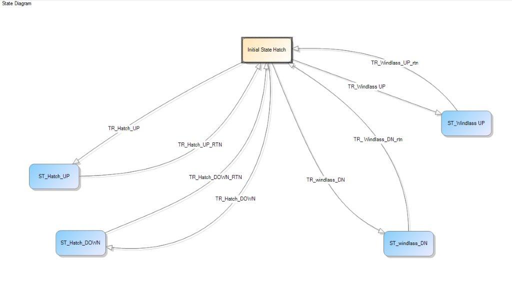

- mark.johns
- Posts: 12
- Joined: Thu Apr 14, 2011 10:50 am
Re: Multiple button press issue
I worked around this issue by creating different views, with only the active button programmed with "Key up".
Using state machine to change view and fire the message on Key Down, and return on key up.
This way as long as key is down, no other key can interfere. So allowing the Key UP operation to work.
Mark
Mark
