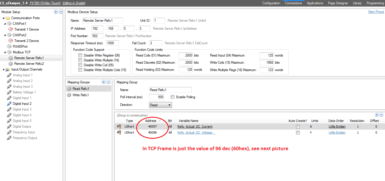

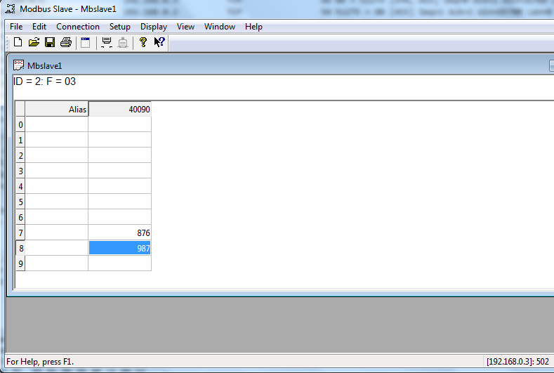

i set up a Client and use the server "Modbus-Slave" for test.
I want to read out 2 holding registers with the adresses 40097 and 40098. This addresses are defined in the slave.

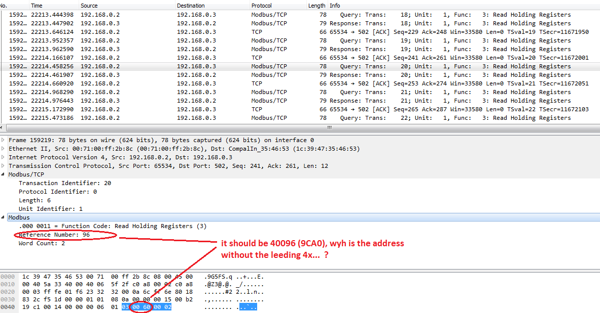

But the output TCP frame shows just 96 with two elements insted of 40096 with two elements.
It generates exeptioncode 2.
If i define the slave with the addresses 97,98 , it works.
What can i do, to read out the addresses 40097 and 40098 ?

Re: ModbusTCP data address fail

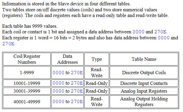

Looks like it is as expected. The leading 4 indicates it's a holding register. The data address is 2 bytes, does not include the leading 4.
