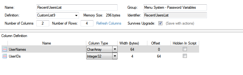

So I attempting to get lists to work in power vision 2.8 as i noticed that it looks like you can save lists to survive power cycles and updates so it look like a useful way to keep a record of users that have logged into the screen recently. Anyways I have been attempting to populate the list but so far i am unable to read(or maybe I haven't successfully written to the list) string values, but i can read ints fine. I have attached my code, it is based on sample code, that worked in 2.7 so I'm not sure if I am just missing something or if there are differences between 1.7 to 1.8 which Im not taking into account. If anyone could have a look over this code and let me know if they can see any issues? I run the CreateEntries method first and then run SetupUserLoginPage method after. I have also attached how I have set up the list.

The first thing I see is the use of the setTextWidgetText(). These don't work as expected. You should use the cultureSetString() to display strings.
Be sure to use the Compile All Scripts button. The Create does not compile the scripts, so if you only do create, you won't really know. Compiles are done on the displays.
The major thing I found is that the first column in a List needs to be an int32. When I swapped the columns, it worked. Who knew! I didn't see any documentation that tells me that! I just tried it and it seemed to work.

Thanks for your response. Changing the order of list so the int32 was first in the list did the trick. Cant say I thought to do that.
