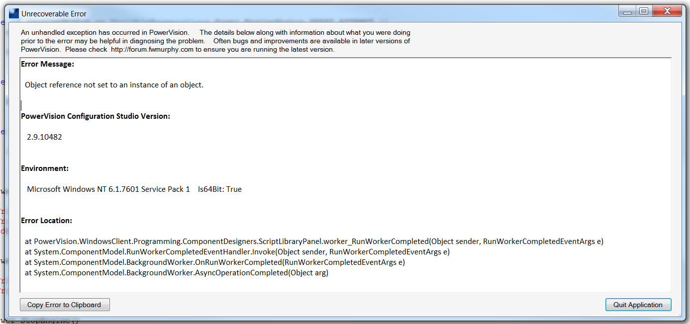

I took my laptop home last night and did some scripting and when I returned to work today, I plugged into the panel to compile and keep getting this error.
I thought it might be a reference that got deleted, but I went through my configuration and can't find any. Have you seen this before, or know where I should look for any issues. I'd hate to start a new configuration, although I'm not super far into this one so I can copy-paste to a new one if need be.
Configuration attached, the work I did last night was all done in the script Faults under #Faults.
Unrecoverable Error

So this has nothing to do with my configuration.
I attempted to create a new configuration added a new (empty) script, then hit compile and I get the same thing. My installation worked fine yesterday, no idea what's going on.

I found it!
At some point I had turned off 'Hardware Connection Checking', probably when I had multiple instance running at some point.
If you try to compile all scripts with this turned off you get this exception.

Re: Unrecoverable Error
Oh good. Thanks for the follow up.
I did get the error message in the Release version. The good news is it doesn't happen in the newer version that will be released soon.
