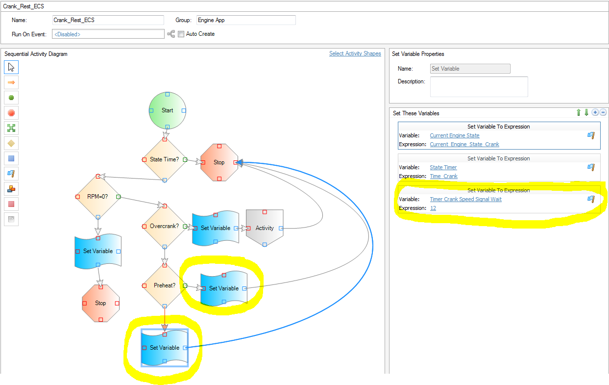

I have discovered a crank cycle bug present in both the public release of PowerVision 2.7.10475 and the MPC-20 release of PowerVision 2.7.10475 - present in the standard MPC20 configuration.
In Crank_Rest_ECS, the variable Timer_Crank_Speed_Signal_Wait is not reset to 12 each cycle.
As such the speed loss error will comeon after a number of cycles (usually >3)
The fix is simply adding a Set Variable after the Preheat? condition that sets Timer_Crank_Speed_Signal_Wait to 12 prior to setting state back to Crank or to Prestart 2.

- Crank_Rest_ECS
- Speed Loss.PNG (78.99 KiB) Viewed 37 times
