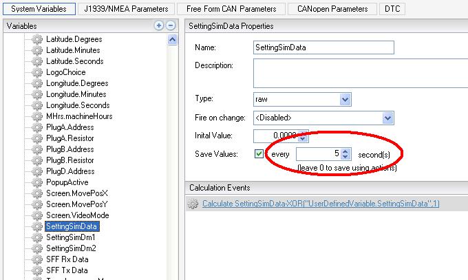

The issue in this case was caused by a bug in the 2.0 release where the configuration tool allows the user to enter the rate at which a user defined variable is saved to non-volatile memory in seconds (as intended), but the PV750 reads that same value as milliseconds. This causes the PV750 to become overloaded if the number is too small. In this particular case, it was set to one, which was causing it to try and save to it's flash filesystem every 1 ms. See the attached graphic Workaround in current release:
If you need to save a variable periodically, enter the number as milliseconds. So, if you need to save once per second (more often than once per second is not currently recommended), enter 1000 for this value.
