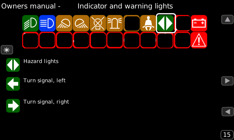

What I meant to do is showing several text + image rows that contain information that is linked to a specific value of one variable.
I use this in a help menu were a Lamp gauge can have several pictures.
When a lamp gauge is selected here, I want to show all the possible pictures of the lamp gauge including a description per picture.
See attachment.
Here the hazard light gauge can also be used to show left and right direction.
Now I have to use one variable for each row. Basically I use one as a counter that indicates which lamp gauge is selected.
In the attachment that is the hazard lamp gauge.
The other 3 variables are just copies of this counter.
Thats the only solution I can think of to circumvent the somewhat strange dependancy between text and variable instead of a 1-1 relation between widget and text.
This prevents me using the same variable into several widgets.
E.g. when I try to enter text in a second widget, the original text of the first widget is overwritten.
N.B. I also found some irregular behaviour when editing the description and or value of the Enumeration Values. It occurred several times that I could not change a value. This was possible again after restarting PV and opening the configuration again.
See attachment.
- ScreenCapture8bMurphy.png (43.65 KiB) Viewed 97 times
