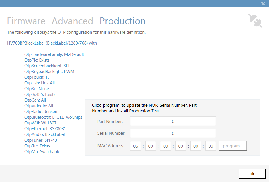

1. The Hardware indicates that a RTC exists on the platform
RTC P1OF3.png (59.31 KiB) Viewed 82 times

There are a few possibilities. The marine versions of the displays do not have a real time clock. The RTC exists flags were set early on even if there was not a RTC. I'm going to email you a link for the latest PowerVision and a firmware update to try. The developers told me that they just recently put the RTC code in.
