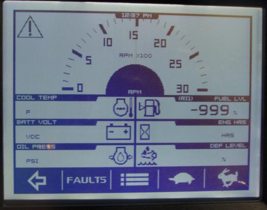

I set the Analog input 1 (by PowerVision 2.8) for the 4-20 mA output of fuel sensor.
When the sensor was connected to the pin 4 (Analog Input 1) of the PV380-R2, "-999%" was shown on the screen.
Please find attached.
Could you advise what could be a problem, configuration side or sensor connection side?
Thank you

Could you send me your configuration file in a Private Message? The test engineer would like to see the IO Definition for your 4-20mA Fuel Level.
