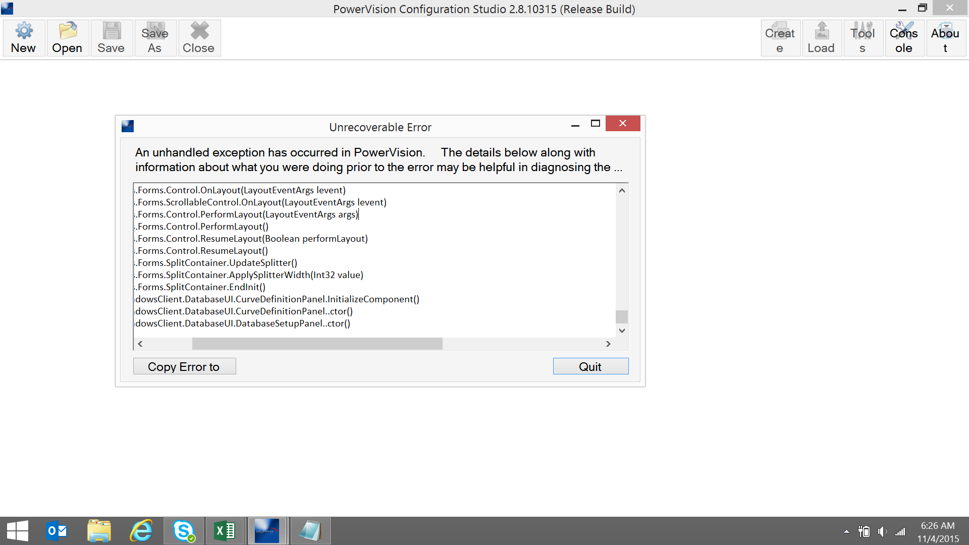

sara
good morning, once again :)
Thank you for the update, and as soon as I get it working, I will put what I make onto the forum. I think it will be very useful.
I have installed the new version of PowerVision, and When I try to open the config you sent me, or any config for that matter, I get a fatal unrecoverable error... I will try to attach the text and screen shot of what I get. I am sure I did something wrong, but I hope it's something I can fix.
Thank you!

Re: OBDII Light Automotive CAN PV450/780
Hello MN575,
Well that is frustrating! Sorry for the inconvenience. I just need more information to help recreate your problem.
What operating system are you using?
Do you start PowerVision Configuration Studio first and then attempt to open the config or just double click on the config?
Have you been able to open any config with the 2.8.100315 ever?
If you start PowerVision Configuration Studio 2.8.100315, can you open any of the built in configs?
Again, I'm sorry for the difficulties and we will try to get this worked out as soon as possible.
