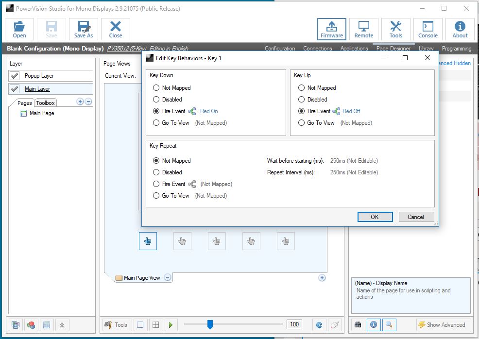

how can the LED's (red / amber) be lit on / off directly on the PV380?
I've searched for a variable which can be used to control the LED's but I didn't found anything.
Any help would be appreciated, thanks.

The LEDs are controlled by Actions of the SysApp application. This defines 2 events to turn on the Red LED and off.
Button 1 down turns on the Red LED and button up turns it off.

Many thanks for the example and information!
