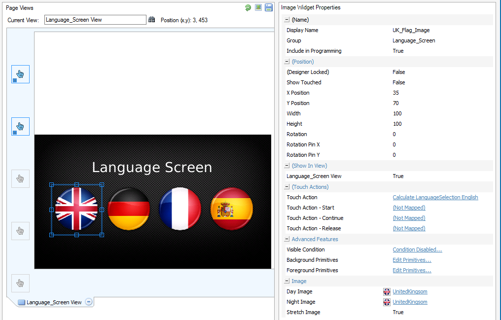

i'm after a bit of newbie advise please, I'd tried several ideas and only result in the screen locking up.
I want to change the language on my config by pressing a an image of the corresponding flag of the country. (I'm using a PV450 Touch)
All the text in my config is using the multi language text widgets, all have the text filled in for the 4 languages I want to use.
I've created a variable called "Language_Index" with enumeration values for each the 4 languages( 0=English, 1=German, 2=French, 3=Spanish)
I've made the flag images fire events on touch, which have an action that fires a condition to set the "Language_Index" variable = to one of the languages above, followed by a "Screen->Process((Empty))" action. It compiles, but the screen locks up when pressing any of the flags.
what am i missing..?
many thanks, Dave.

After testing the configuration I see it is causing a loop. What you can do is fire calculation events rather than the condition events. I added enumeration values on the LanguageSelection variable with calculation events:
The touch action fires the calculation event:
This is changing the LanguageSelection variable directly. You can change it to change the Language_Index variable if you need that.

Calculation events:

Many thanks for this boyce, works like a dream now. I didn't realise there was a screen application "Language Selection" that already existed.
