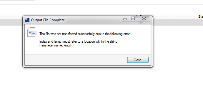

I have have just installed the new version of Power Vison to a new Computer.
I am programming using an ethernet cable and single USB to Ethernet adatoptor between the PV450 and cable. The network connects I am able to debug the code over this connection.
However when I try to upload a new configuration (I've have tried both my program and the default program) I get this error (see photo).
Any advice on how to fix this would be greatly appreciated
Loading to PV450

- PV error.PNG (18.04 KiB) Viewed 103 times

Re: Loading to PV450
This is previously unsed PV450. Could this be the issue.
Hello CustomFP,
Did you create a full install and upload it?
Does it reprogram with the USB? (I'm assuming the problem has been when you upload from PowerVision Configuration Studio).
I believe this was the problem. A full install and load has allowed me to get around this error.
Regards,
