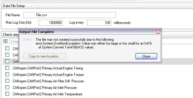

When I set the file size to anything greater than 32,767 kb (2^7 kb) and try to create a config, the following error.

Whenever I try to set the logger size to anything greater than 32767 kb (2^15 kb) and try to create a .tar file, I get the following error. It is kicking out of file creation at "Generating Configuration: NVMgr"
Log File Error.JPG (40.02 KiB) Viewed 73 times

Thanks. I will get it added to our bug list.
