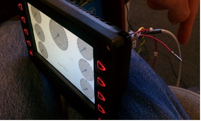

I too have an issue with the ignition switch on the PV750. If the unit is powered up and the ignition is then switched off, but BATT+ is held constant on on pin 1, port A, after an hour or two, the unit lights back up and will remain on. This is without the ignition wire connected (see picture). The only way to turn the display off again is to cycle the ignition contact.
I am using Windows 7 OS and the PowerVision Configuration Studio (Release Build) 2.2.10525 (2/14/2011).
I have a customer who is using the ignition switch to turn the display on/off. He is not breaking power to the PV750. What is the fix for this? I assume that this will require a firmware update, but if there is something I can do on the configuration side, please let me know.

- PV750 Ignition Disconnected.jpg (42.92 KiB) Viewed 119 times

How are you switching it off? Are you just removing ignition? Just removing ignition just kills the backlight.
With Bootloader 2.1.1 installed (previous version reboot the display), you can set a state machine to fire CCM-Shutdown upon the event Sys.IgnitionOff. This will actually power down the display. I have not tested it for long term (I will tomorrow), but my customers are also just using the ignition.

I am switching the ignition off by just removing the ignition. It does kill the backlight, but eventually, the backlight turns back on. What would cause the backlight to come back on without B+ to the ignition?

I'm not doubting that the backlight coming on is indeed a bug. I'm just pointing out that the display is not turning off just be removing the ignition. This can be importanmt if you need default values to load or state machines to run at startup.
Anyway, a work around for you may be to fully shut down the display as described in my earlier post.
